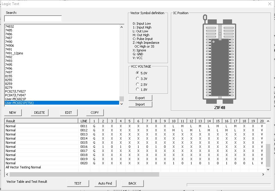

Good morning I tried to carry out the test of some new ic 6821 as proof, but the test gives me many errors . That? The cip are new, recently bought. What am I doing wrong?Thank you all

Hello, I have the same problem. I have tested more han 10 MC6821P chips and Autofind fails and Test fails by the TL866+.You can see here my 3 pictures attached.
Is there any specific setting to apply or something ?
position
Autofind result
Test result

Tl866 II, T48, T56, Not support this MC6821Chip.Best regards
Thank you for your reply. But then why is it in the TL866II_List.txt ?
回复 8# papi
Sorry.Because T48 and T866II is not a VCC on PIN20 , so it only Tested on T56.
and it is a bug we will fix it.

it has been explained:

No note, only T56 support.
In the logic test, there is no classification of programmer models for supported chips
