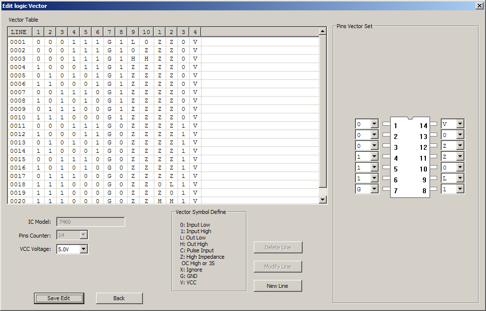

Corrected Logic Test - 7460 Vector Table
Vector
Logic
7460
Corrected

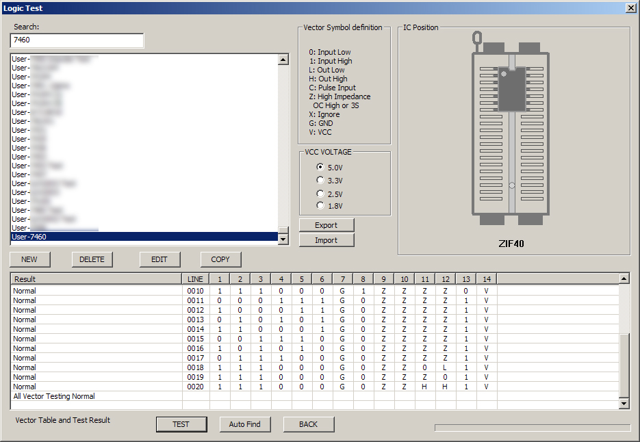

Attached is a revised Vector Table for the
7460
logic IC.

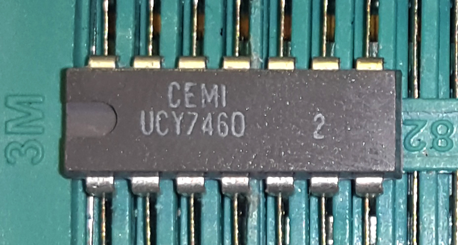

The proof test was performed on the UCY7460
(Dual 4-Input Expander)
chip from Unitra CEMI
(Poland)
See also:
Bad Logic Tests for 7460 and 7462 ICs.
