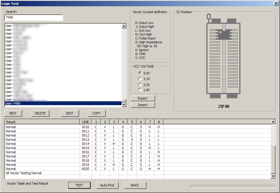

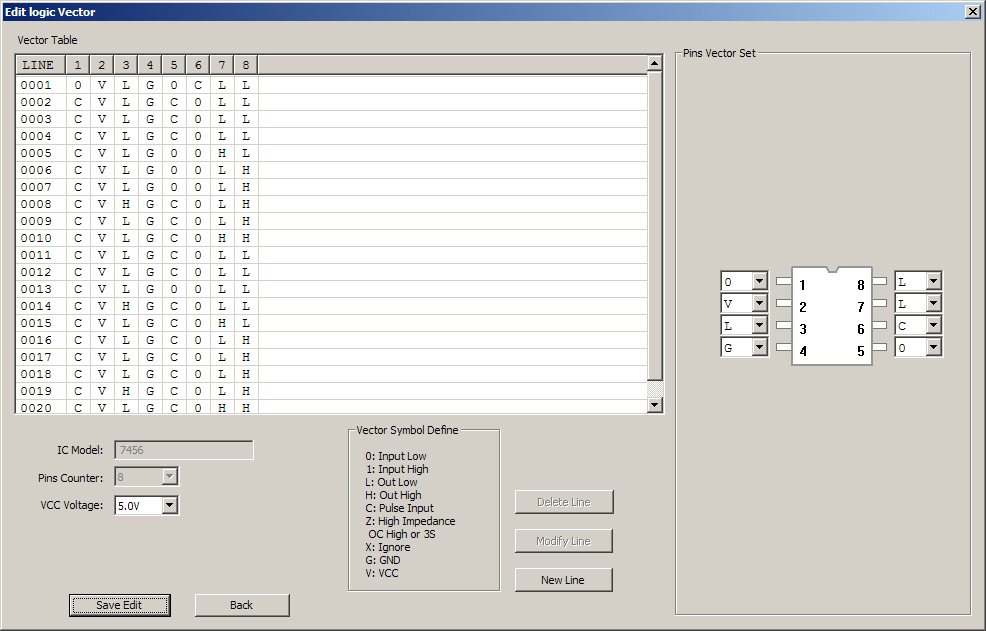

New Logic Test-7456 Vector Table

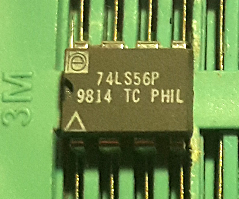

The test was performed on the 74LS56P (Frequency divider: 5 to 1, 5 to 1, and 10 to 1) chip from Rochester Electronics.
