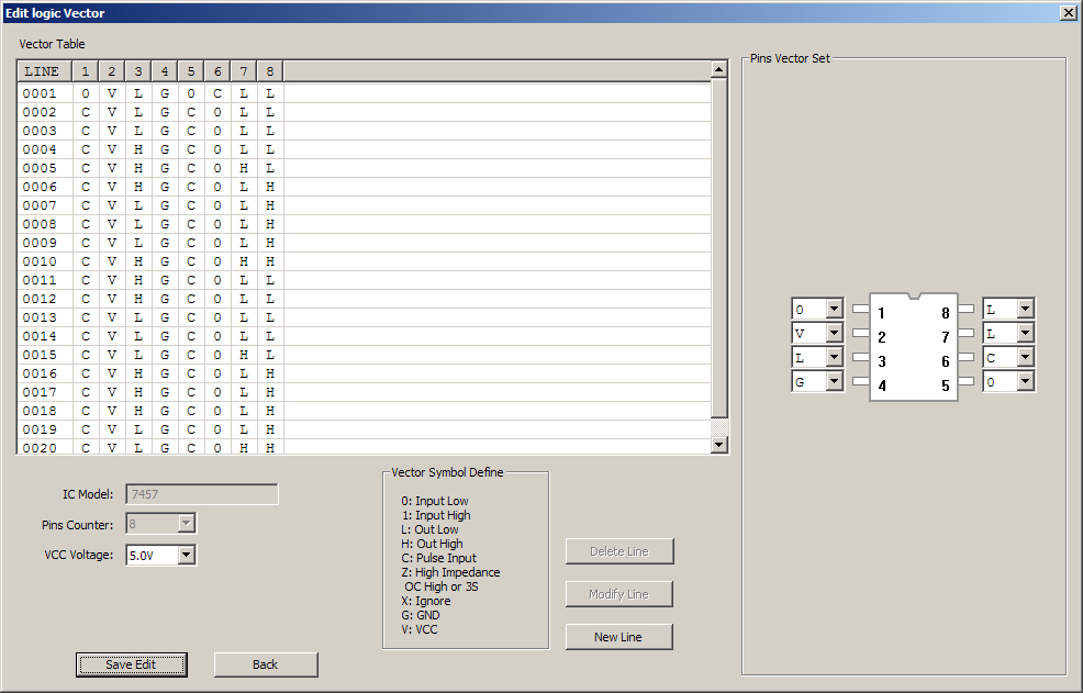

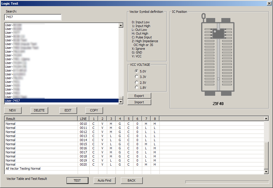

New Logic Test-7457 Vector Table

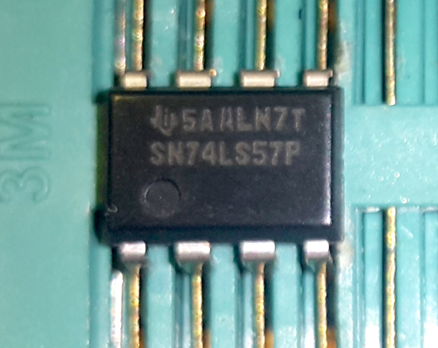

The test was performed on the SN74LS57P (Frequency divider: 6 to 1, 5 to 1, and 10 to 1) chip from Texas Instruments.
