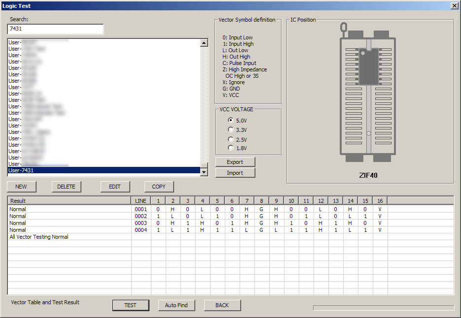

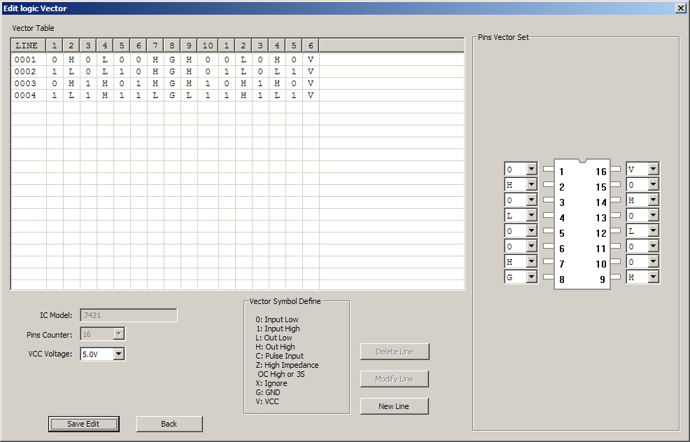

New Logic Test - 7431 Vector Table
New Logic Test-7431 Vector Table

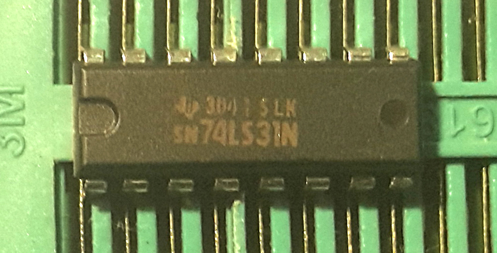

The test was performed on the SN74LS31N (Signal Relay) chip from Texas Instruments. |
