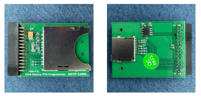

2. Completed support for SDNAND and TF/SD 1.0/2.0/3.0 cards, with read/write speeds up to 20+ MB/s. The SDNAND chip uses the WSON8 high-speed socket, and the TF/SD card uses the T76 dedicated SD card adapter.

New dedicated adapter for SD/TF, and some latest other adapters. not yet seen for sale.

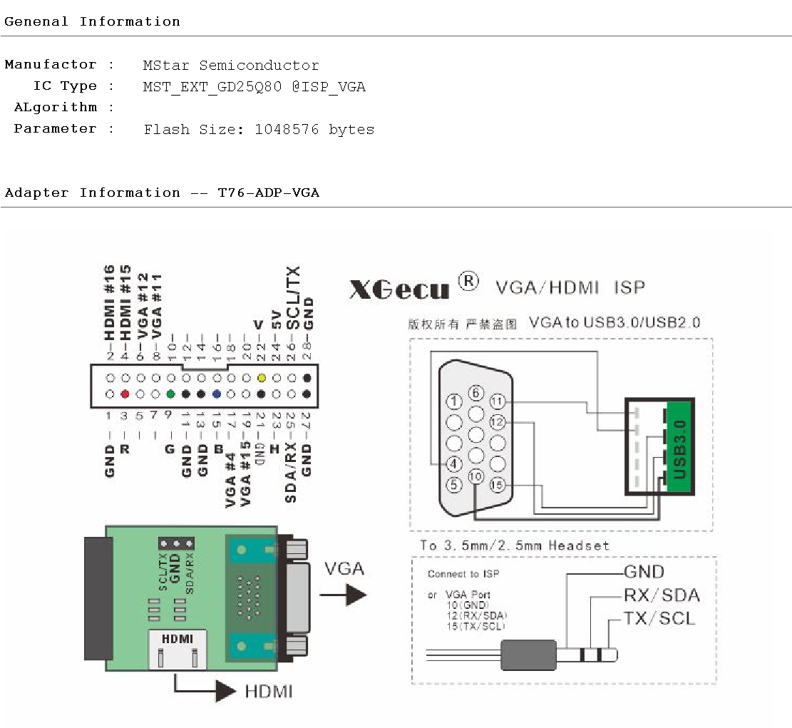

  With Software 13.11 for T76, it brings the need of a new VGA adapter for the latest added functions, not yet seen for sale.... T76-ADP-VGA

NOTE: Found info, that first batch of T76 VGA adapter board, need a simple rework, to work correctly with
latest's XGECU software . Read Here VGA adpter only for XGecu T76 Programmer support VGA interface HDMI-compatible
