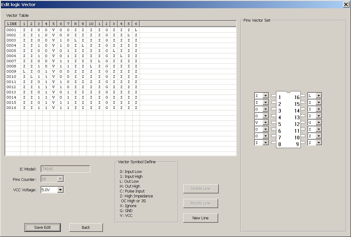

New Logic Test - 74141 Vector Table
Logic
74141
Vector
Table

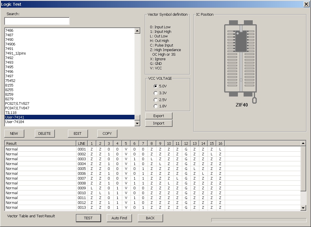

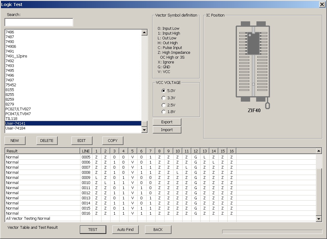

Enclosed is the new layout to be added to the logic tests (add in XGecu).
The test was performed on the SN74141N (BCD to Decimal Decoder/Driver).
