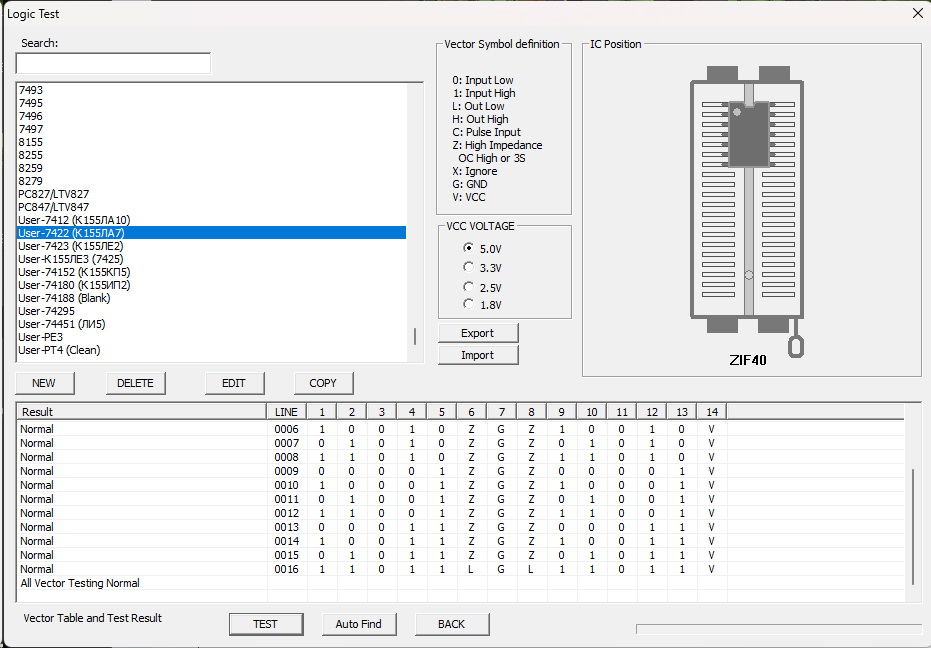

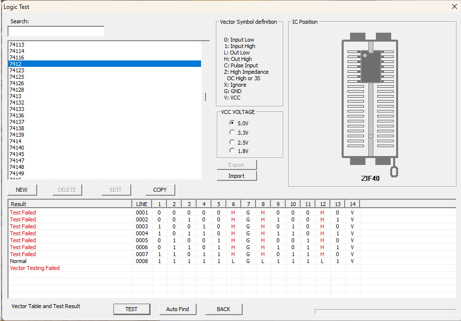

Hello.

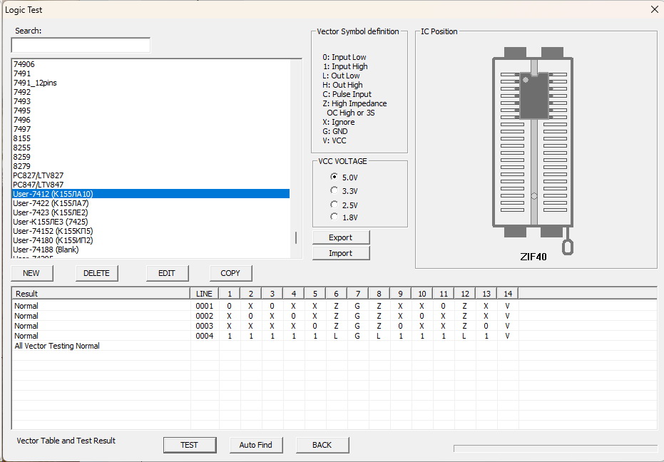

I want to share my logic tests, which are not in the programmer or are, but with errors..7412 (Russian К155ЛА10) - bad test in programator, instead of (High) - it is necessary Z (open collector)
7412.lgc (2.15 KB)

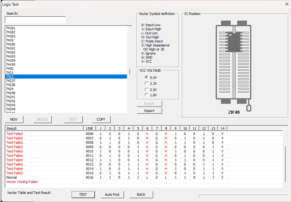

7422 (Russian К155ЛА7) - bad test in programator, instead of (High) - it is necessary Z (open collector)
7422.lgc (2.43 KB)

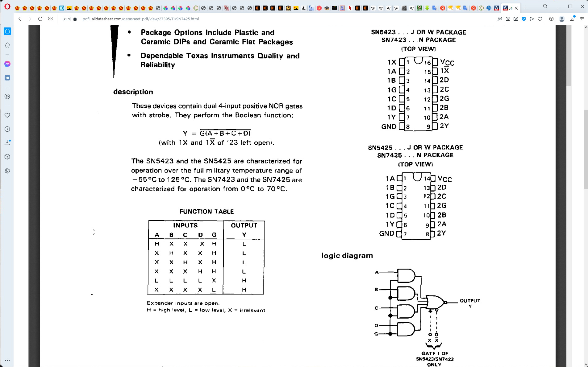

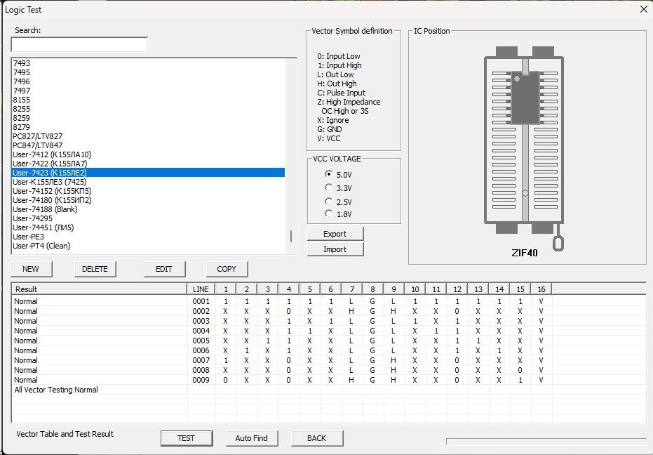

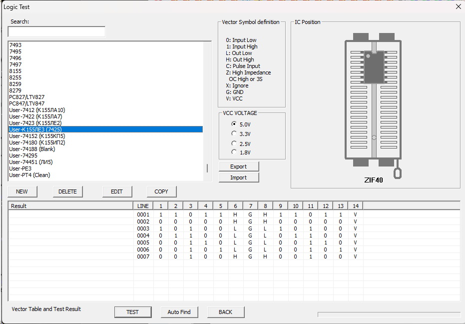

7423 (К155ЛЕ2) & 7425 (К155ЛЕ3). 7425 bad test in programator, the microcircuit has 16pin, not 20pin.
7423.lgc (2.27 KB)
7425.lgc (2.22 KB)

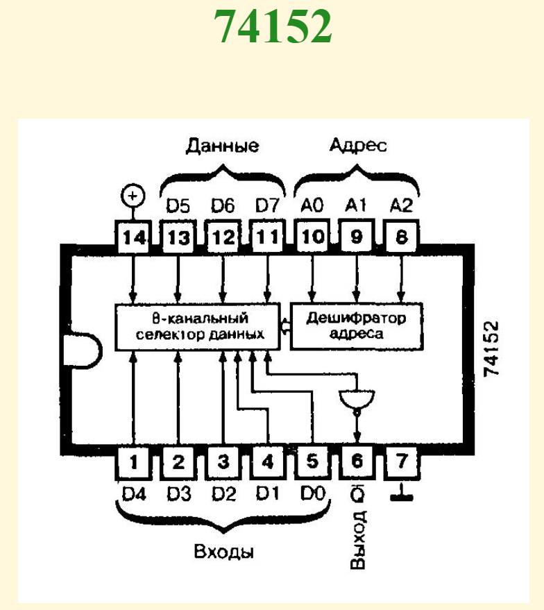

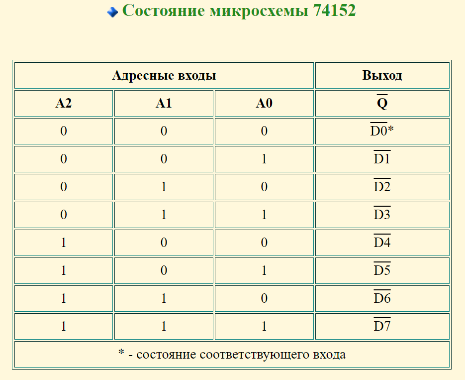

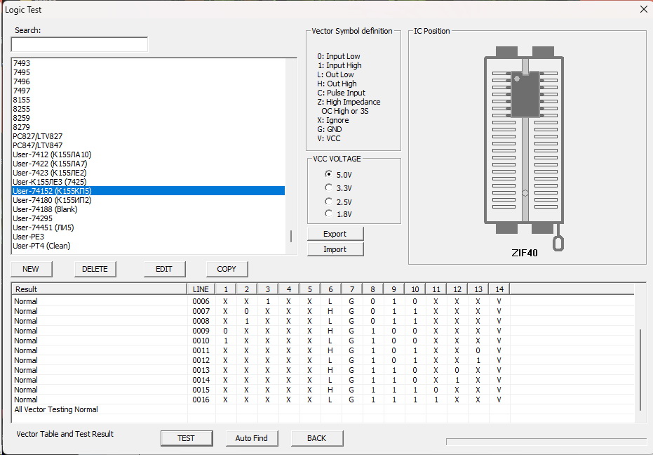

74152 (К155КП5)
74152.lgc (2.43 KB)

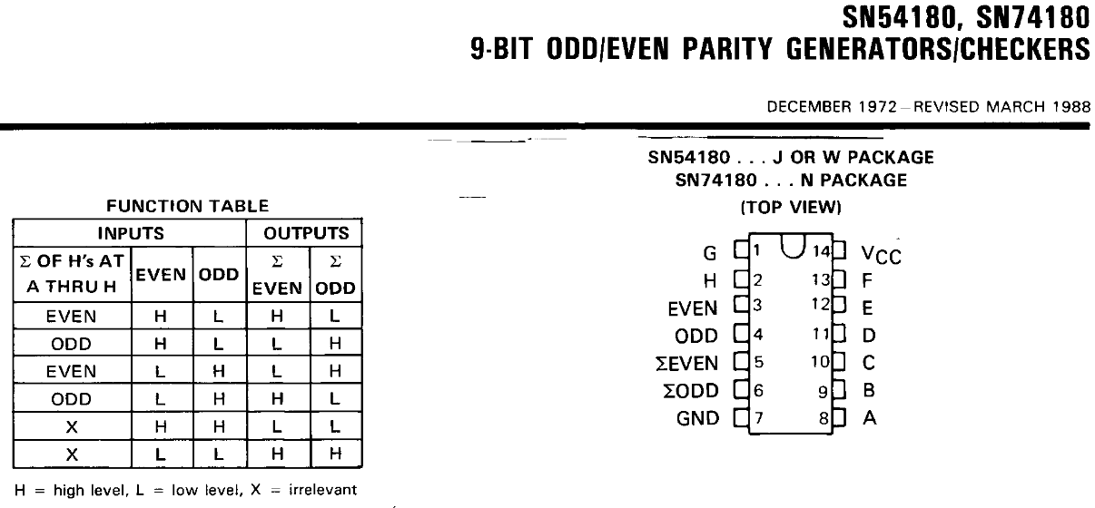

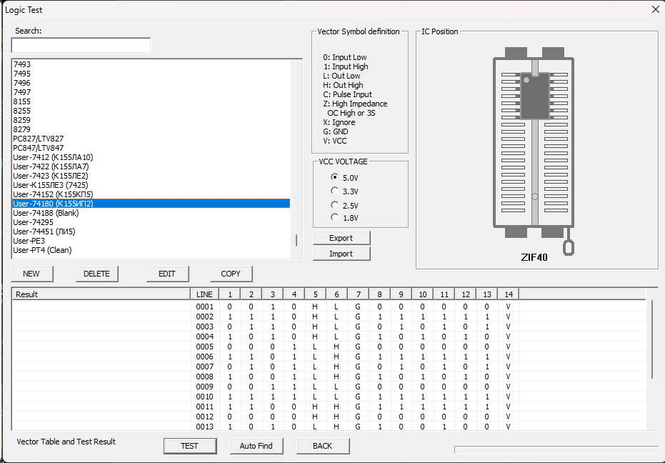

74180 (К155ИП2)
74180.lgc (2.48 KB)

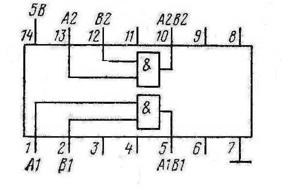

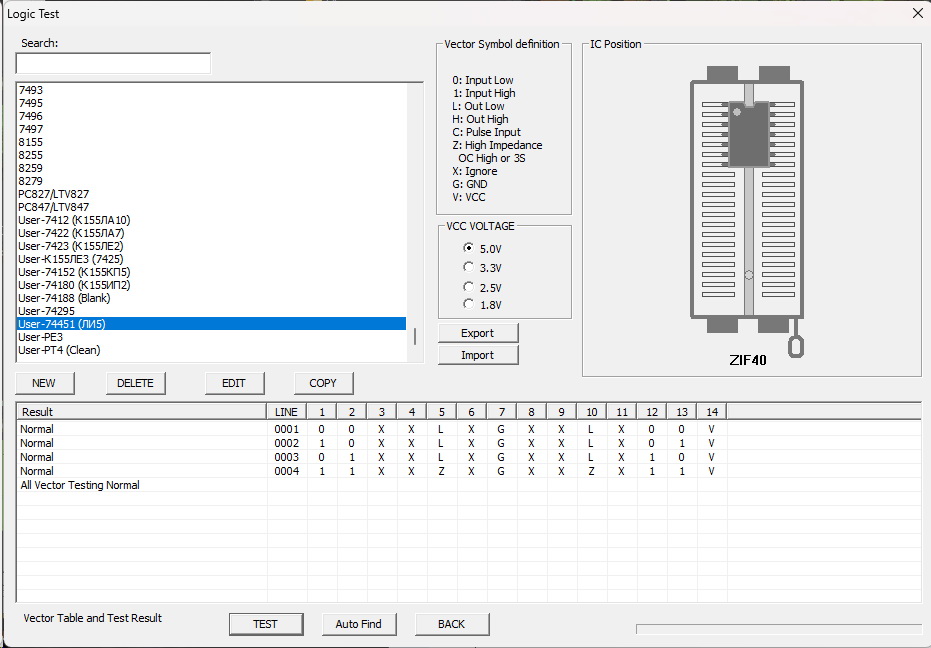

74451 (К155ЛИ5). Open Collector
74451.lgc (2.15 KB)
