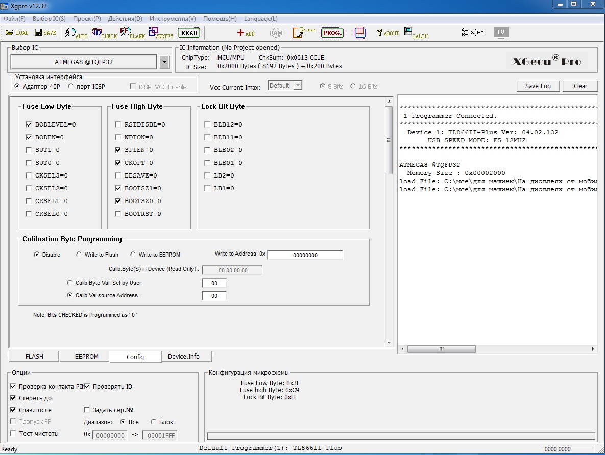

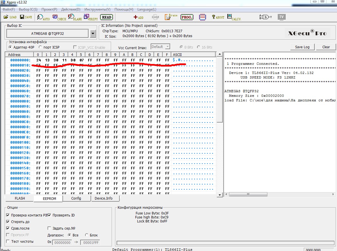

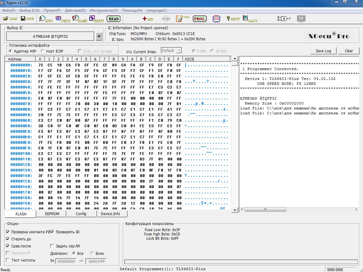

I am using TL866II Plus. The program does not correctly read the eeprom from the file. The program reads and writes Flash and config correctly, but not eeprom. This is how it started after updating from version 11.81
I also use the AVRDude programmer to flash atmega chips and I have no problems with it. AVRDude reads the flash and eeprom files correctly and the atmega flashed device works. And if I flash the atmega chip with flash and eeprom files with the XGPro program, then the device does not work correctly.
I am flashing atmega8, atmega16 chips in tqfp package.

Device configuration item is not set! There is no configuration information in the saved file.
you must set correct Fuse low byte and  fuse high byte .

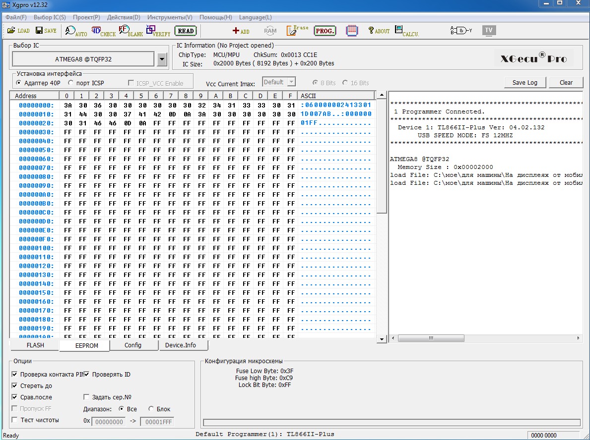

here is an example eeprom file that AVRdude reads and flashes correctly, but XGecu does not.
1.rar (108 Bytes)

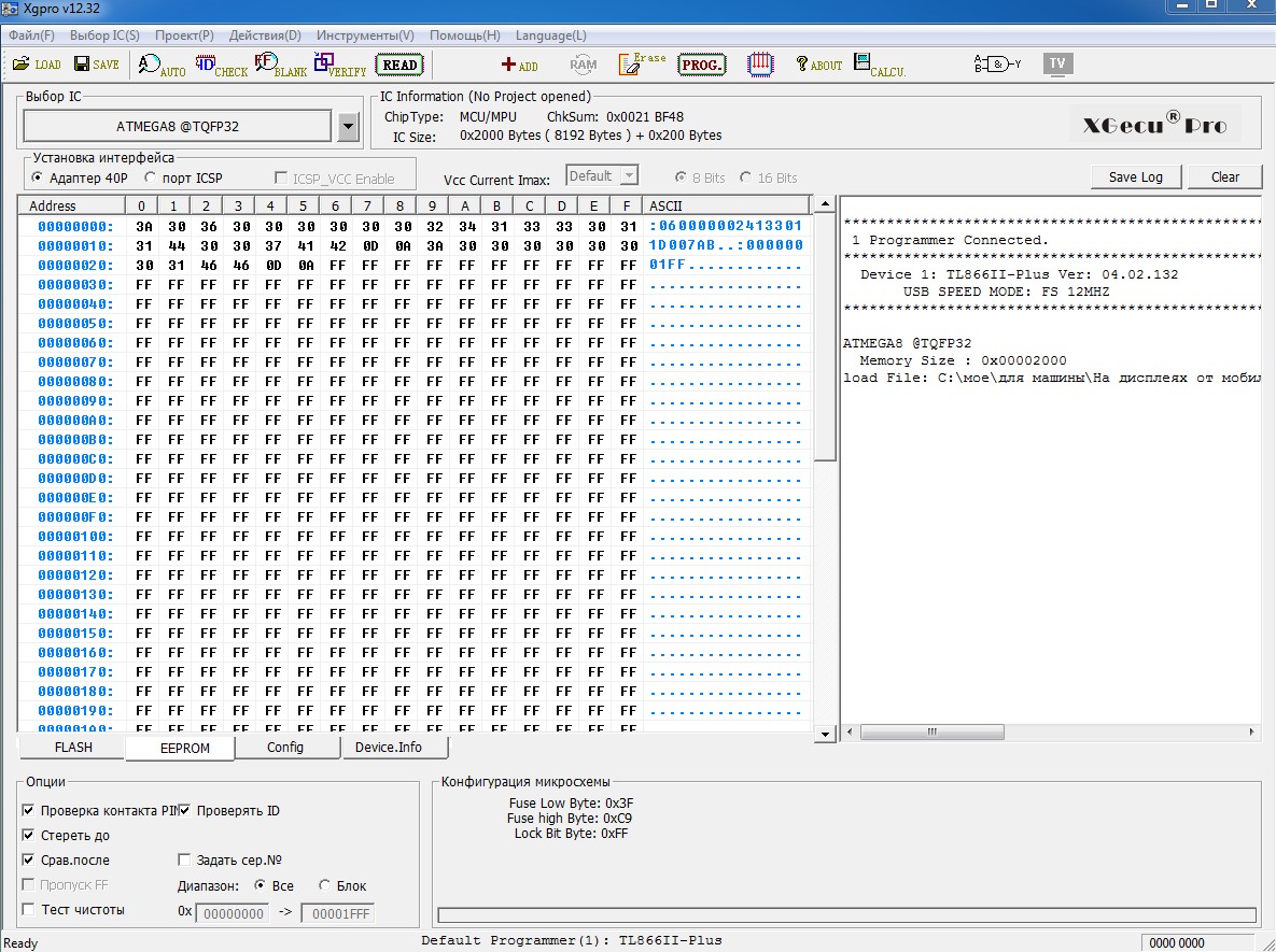

this is how it should be right
this is the same eeprom read from the chip flashed by avrdude and it works correctly!
this is the same eeprom read from the chip flashed by avrdude and  ...

I can conclude that the program correctly reads the eeprom from the atmega chips, but the program cannot correctly read the eeprom from a file on the computer if it is not a .BIN file
thanks for 11.81 :handshake
I can conclude that the program correctly reads the eeprom from the atmega chips, but the program ca ...
tomas37 发表于 2022-10-20 22:41
   Hello:  Have you tried to open the EEP file , using 'INTEL HEX' mode?File Load options, choose the EEP file, in the file format (left) change to INTEL HEX, and press ok.
yes, it worked!!! Thanks! :D
