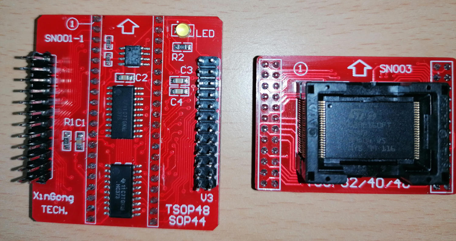

Hi,
i have an Xgecu TL866II Plus programmer and ordered an TSOP48 Adapter Board (SN001 V3 and SN003). When i try to read the flash chip M29F160FT i only get the message "check adapter and position" from the software Xgpro v12.32.
I read that there are fake adapters out there so i'm wondering if i got one. I ordere the adapter from here:
https://www.aliexpress.com/item/32994124021.html
and it says that it is the official Xgecu store.
How can i check if my adapter is a genuine or a counterfeit one?
Or what else could be the problem that the adapter seems not to be recognized?

回复 2# quakeman
It is possible that the adapter is bad. try to Solder all solder joints again.Especially the two resistors on the left of SOIC8 Key IC
