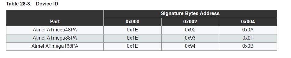

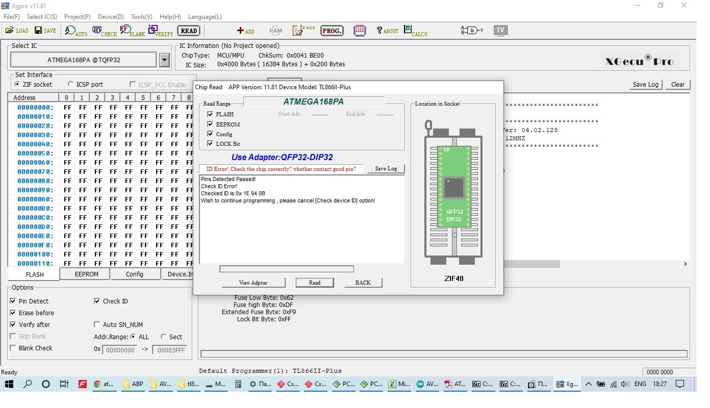

ATMEGA168PA ID ERROR
Why do you have new
bug
s in every new version? Why can't you make one stable version? I used version 11.00, it worked fine. Updated to 11.90 and can't prog
ram
ATMEGA168PA properly. Writes ID ERROR. I have to disable ID verification.
