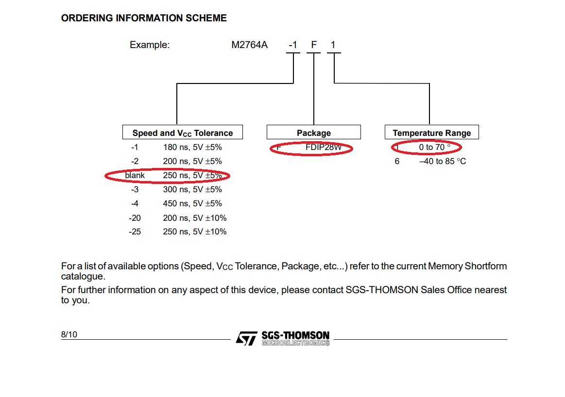

   Hello, As an user.... Which programmer, and software version do you have? At least it looks like that over TL866II and T56 it's already there. Do you have any message?
Download Newest XGecu T56/TL866II software - Programmer Use & Software Download - XGecu Programmer Forums - Powered by Discuz!
M2764A datasheet(1/10 Pages) STMICROELECTRONICS | NMOS 64K 8K x 8 UV EPROM (alldatasheet.com)

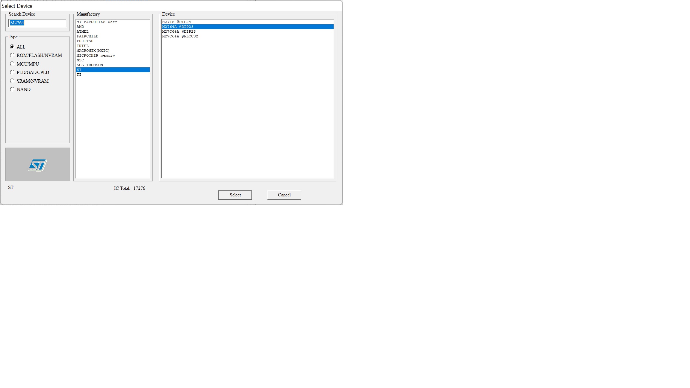

Thank you very much for your quick reply!
I have the Plus version, latest software.
I could not find the chip -AF1 version. So I thought it needed to be added.
Do you think programming will work with the software using the -A setting (question) ?

joopklep 发表于 2022-1-17 17:33
   Hello... as an user. Sorry if i am wrong :-(
I think it will work. Anyway some chips are remarked and gave ID error.
If Chip is correct you can put ID : XX XX Here and maybe ADMIN will help
to select the correct Chip, or at bottom of app window, left side, you will find
the tick to ignore ID. Any error, post here image :-)
M2764A....
F=it means DIP28 version
1=it means o to 70 deg version

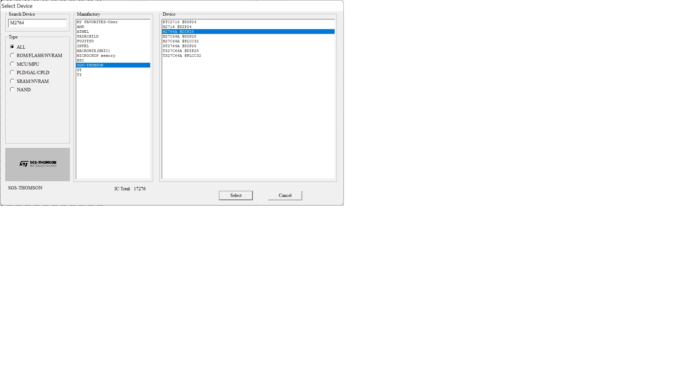

I can confirm that I have succesfully programmed the chip in the picture (SGS-THOMSON M2764AF1) with the setting for M2764A
Great Success!
