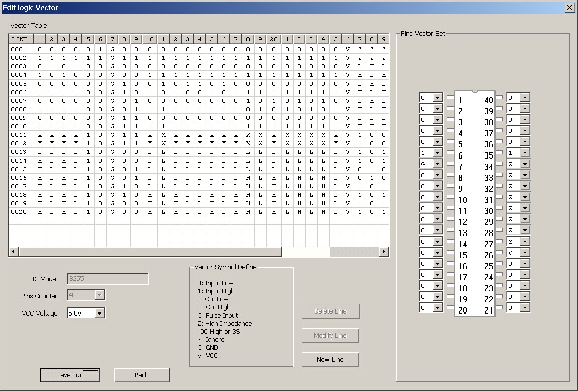

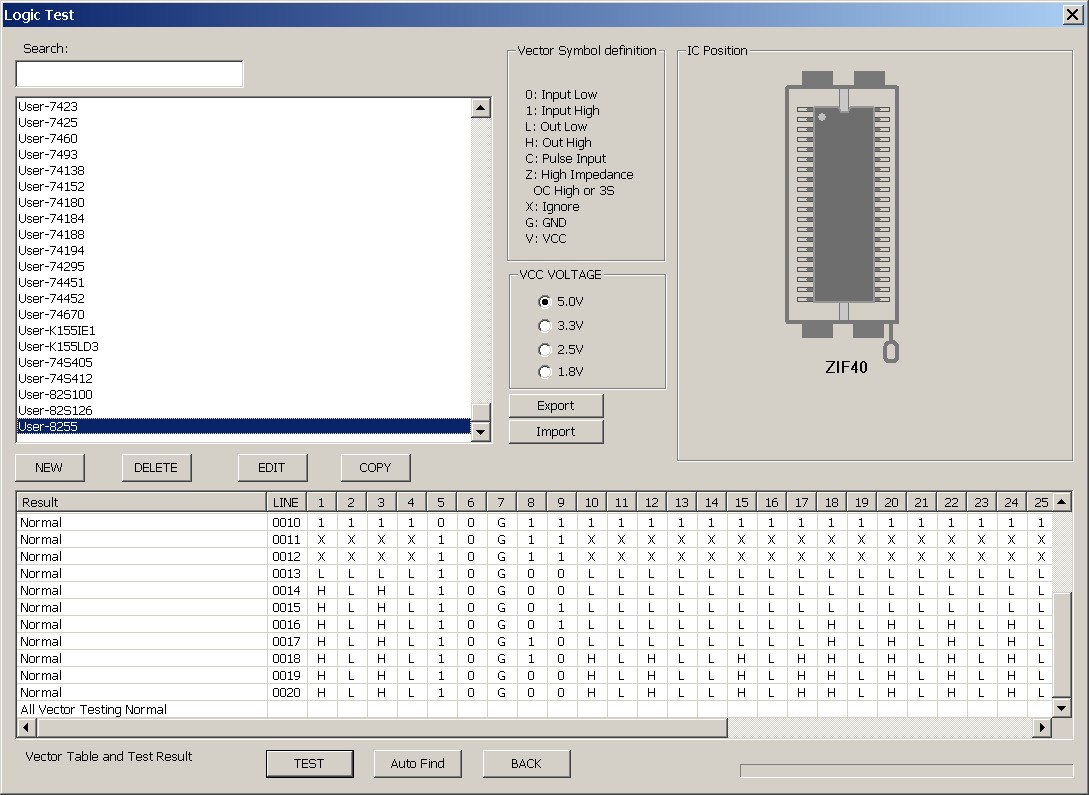

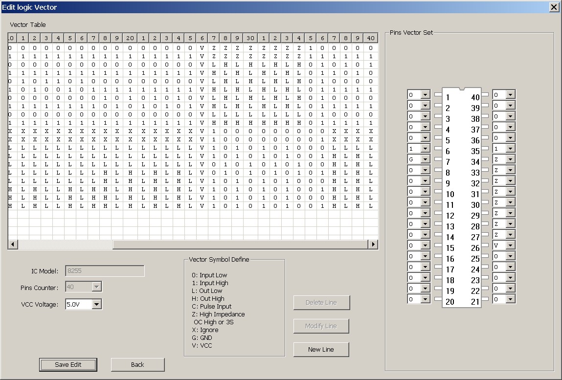

Corrected Logic Test - 8255 Vector Table
8255
Attached is a revised Vector Table for the 8255 logic IC.
The test was performed on the NEC D8255AC-2 (
PROGRAMMABLE PERIPHEAL INTERFACE
