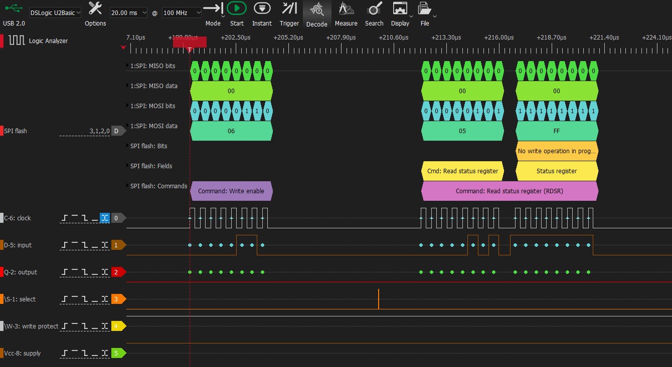

I have connected a logic analyzer to debug the communication. I can see that a WREN (Write enable) operation is send, but it is followed by a RDSR (Read status register) operation, while I expected a WRSR (Write status register). What am I missing here?

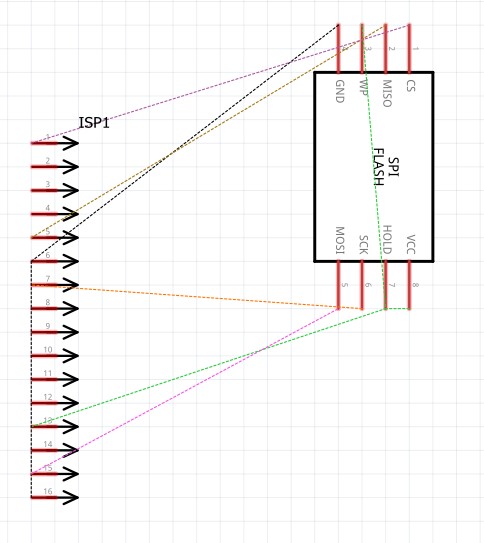

I have added some images that hopefully should explain what I am doing. I am trying to program the status register to see the operations. However, I can see that I am missing the WRSR (Write status register) operation after WREN (Write Enable)

M95640-W schematic connection - no test connections.jpg (49.33 KB)
Schematics
Logic analyzer - Program status register.jpg (178.5 KB)
Logic: write status register

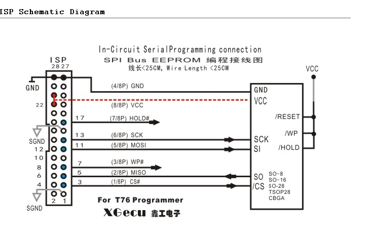

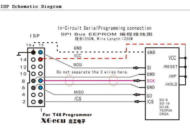

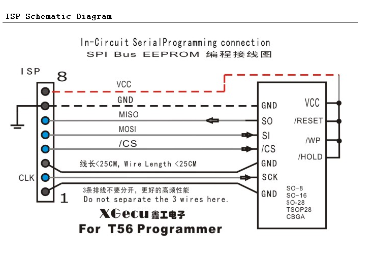

[attach]2277[/attach]
You can see that they recommend lower then 25cm... For T76, T56 or T48, and recommendations
for clock lines....
Screenshot 2025-03-21 143857.png Screenshot 2025-03-21 144058.png Screenshot 2025-03-21 144220.png
You show, in the proto board the IC in an adapter that may fit the programmer socket directly,
then length cables at the lowest :-)
If any software change that may help you, hopefully Admin read this, and implement.

I am following the guide for the clock. The M95640W is shown in the schematic and could be wrongly interpreted as being in a programmer socket, but it isn't. I have used in-circuit (ISP) using a similar probe as 1PCS Ultra long spring clip burning needle burning writing cable download cable no disassembly chip freeing hands - AliExpress 13.

When I issue a Program Status Register command in the Xgpro Windows program, I still see a sequence of operations I didn’t expect. I have tried with different speeds with same results.
I still see that the T48 issue a WRSR (Write status register) operation after a WREN (Write Enable) operation, while I would have expected a WRDI (Writs status register) operation.
There is no insight into how the T48 is functioning when issuing the program operation. Thus, it might be the way the T48 operate. Is there somewhere where the way the programmer operates is described?
