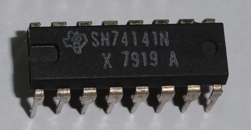

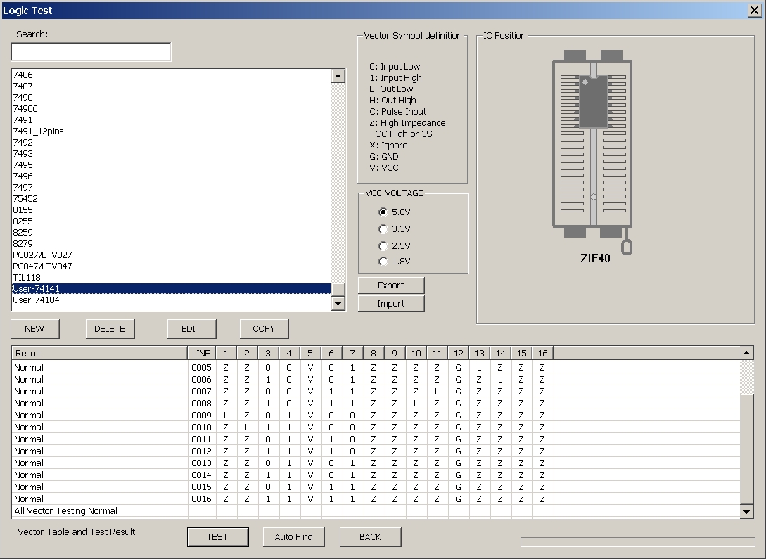

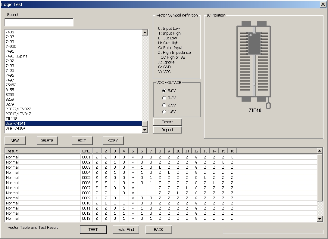

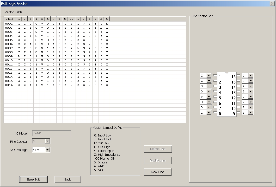

Enclosed is the new layout to be added to the logic tests (add in XGecu).
The test was performed on the SN74141N (BCD to Decimal Decoder/Driver).
