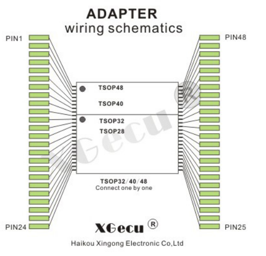

NAND wiring diagram for T48
How can I wire a NAND IC to T48 programmer?
Please send a basic diagram that show which NAND pin connects to which T48 pin.

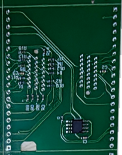

The fastest speed for programming NAND on T48 is 6-10MByte per second. There are process requirements for making circuit boards, and customers are not allowed to make the adapter by themselves. There is also an encryption chip on the back.
I'm referring to TSOP48  NANDs, low speed, used in routers, There is a diagram for T56 (see attached), I need the same but for T48 programmer.

Is there anyone in the community that owns the ADP_F48_EX-2 adapter and can do a reverse engineering of it?
It is not complicated, that small chip on the back ("encryption" chip) is most likely an I2C eeprom used for adapter identification, it can be read easily.

I ordered the adapter and I promise to reverse engineer it and publish for everybody but I need to wait 3-4 weeks to get the adapter.

The usage method of T48 is exactly the same as T56, and the adapter has prompts in the software according to different programmers.

The adapters of T48 are all open, except for adapters with more than 40 pins, which is due to the 48 (or more pins ) to 40pins .It is dedicated and cannot be shared with other programmers, and T48 can not use other adapters(more than 40 pins) of  other programmers.
