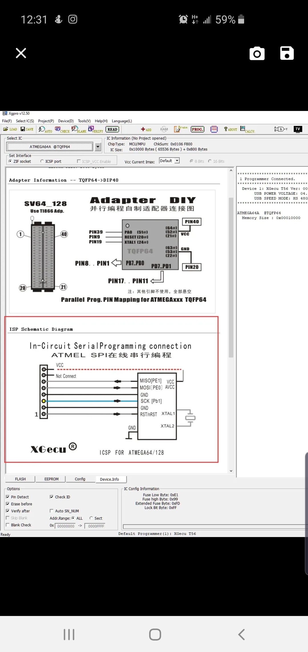

i have problem to read chip atmega64A IN XPROG BOX V6.12 WITH XGECU T56
I connected 7 wires according schematic(reset,gnd,sck,gnd,mosi,miso,vcc)
when i try to read the id error come out
uncheck id,try to read everything 0000
how can I solve
Thanks in advance

Upload the connection diagram. And photos

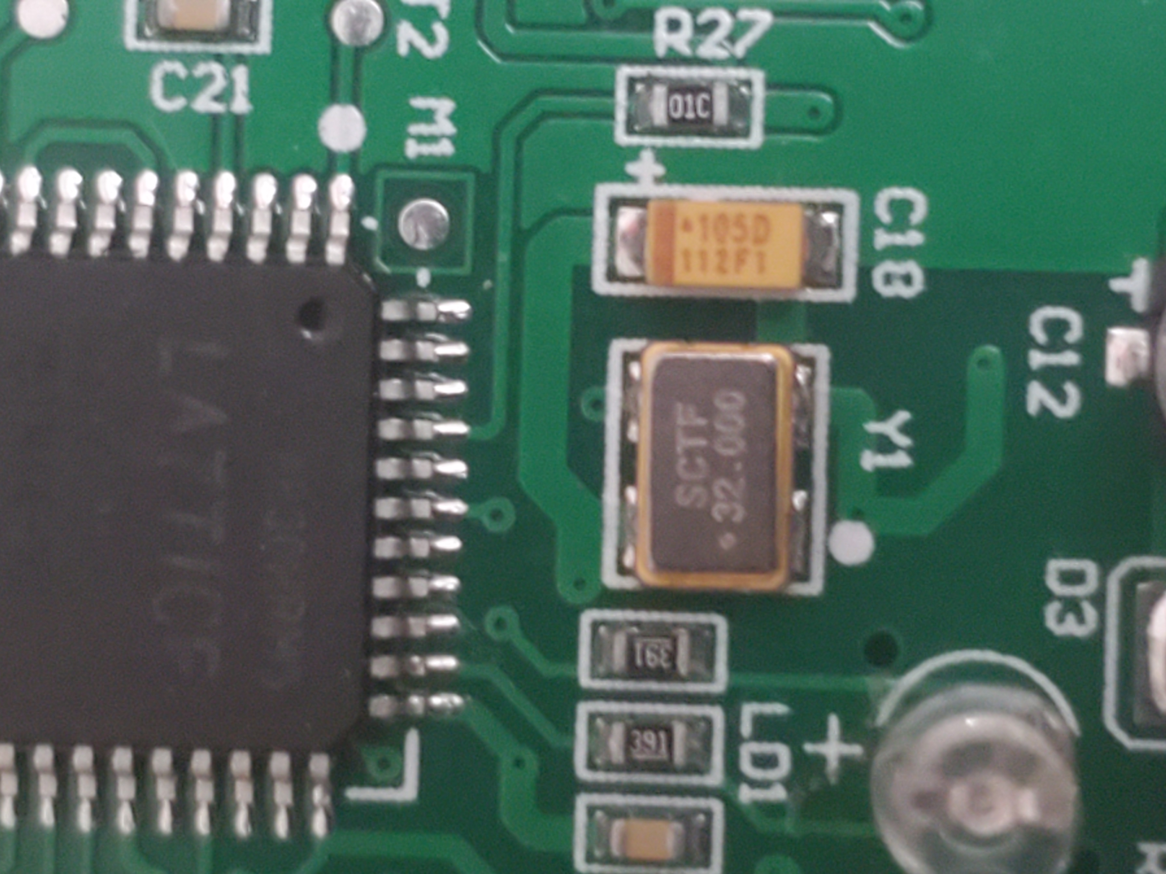

Is there a connected crystal oscillator?
please can you help me to read a chip
If you use ICSP Port you must check "ICSP-Port" on the Top where it named "Set Interface"
